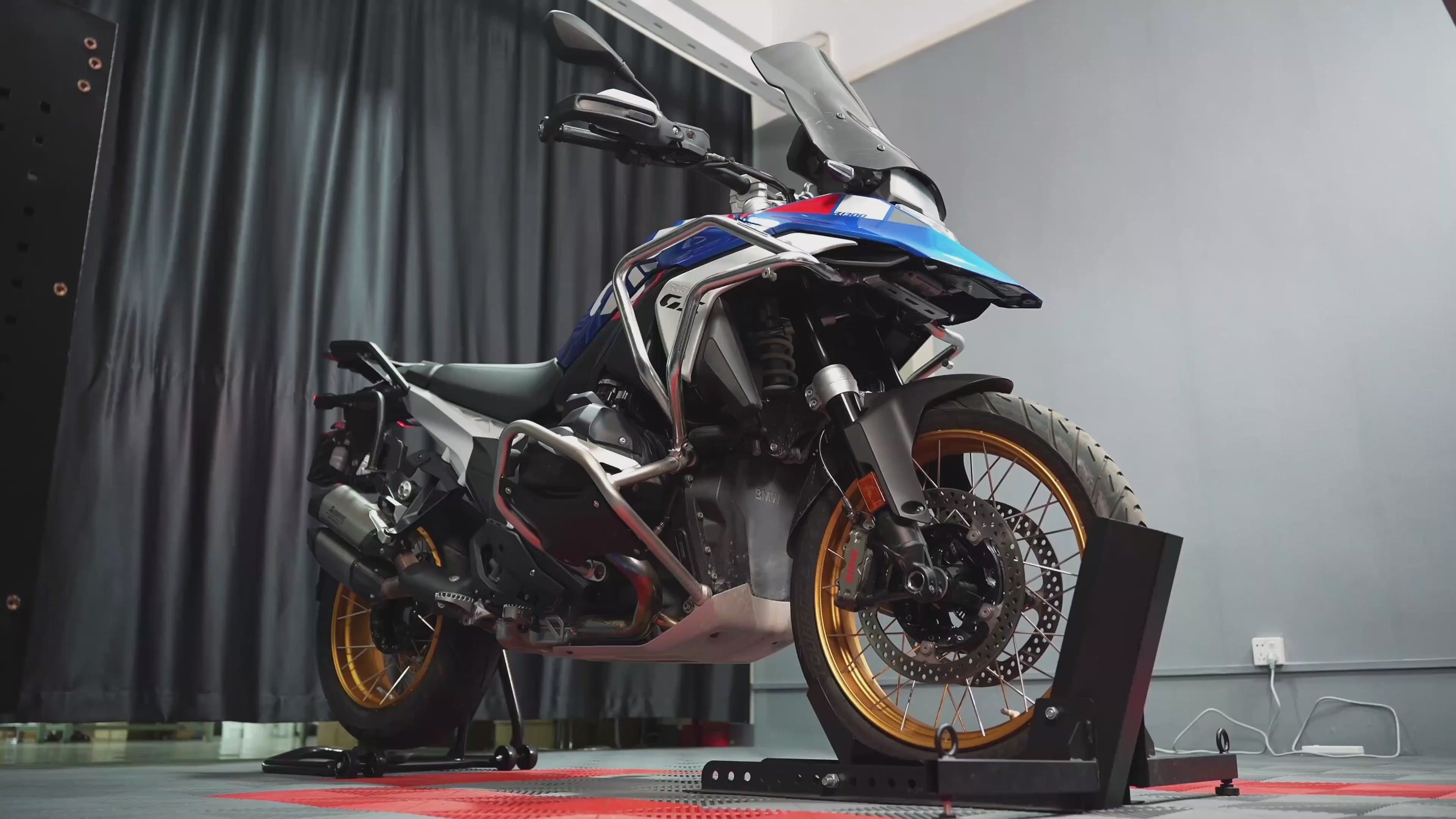

For First-Time Users
N3 (BMW) Installation Showcase
Take a quick look at the installation steps.
